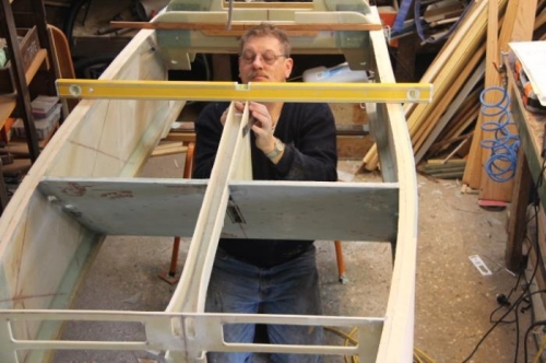

Re-levelled fuselage and re-bondo'd.
Trimmed new stuff. Heat duct is straight & bottom is curved. Adjusted profile, removing 5mm at rear. Sanded all bottom surfaced to be bonded.

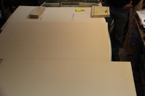

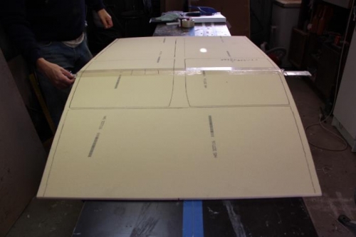

Cut bottom foam to fit & marked internal positions. Cut to fit perimeter and joined foam with 5 min epoxy. Achieved best joining result so far by taping straight edge to back of join. Box tape dispenser made the job a lot easier. Mixed a new batch for each join and smoothed with old credit card. Both sides of join need no trimming afterward, (for the first time).
Trimming heat duct
Trimming heat duct
Cutting bottom foam to length
Joining foam with hing method
