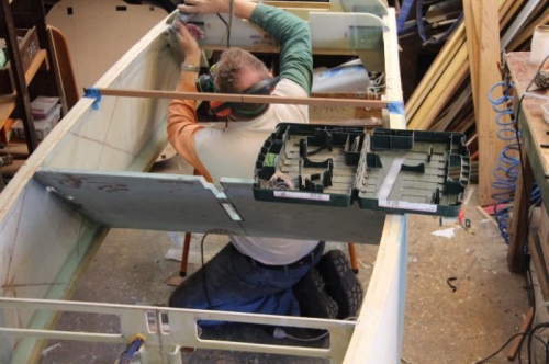

Noticed the transition in the lower longeron from square to triangular, and thought it looked a bit awkward, and was keen to make it look better. Was concerned it may have some function, so read ahead to see. In Chapter 09 Step 1 I found instructions to smooth it! This is just dumb, there is already 3 layers of glass on it, and more to come before Chapter 09. Smoothed it now to a pleasing shape with multitool and 'dremel' with a 1/2" sanding drum. I see no reason this should not have been done in Chapter 05 before taping the newly installed woodwork, and some advantage to doing it then.
The Dremel I bought to make this aircraft died before I started, the $50 Ozito I replaced it with has already outlasted it, though the bearings are getting a bit squeally. Will continue to call it 'dremel' with a small 'd'.

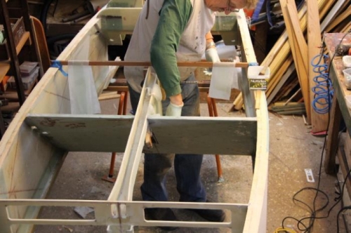

Plans have you assembling the Seatbrace to the Heat Duct, then installing it the next day. I floxed them into the fuselage then taped them together, clamping them into position. Got back one of the days I wasted on the Heat Duct debacle.
Smoothing Lower Longeron transition
Taping Seatbrace
Taping Seatbrace
