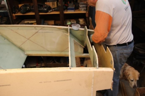

Brief Description:  Fitted Lower Permanent Firewall
Trimmed yesterday's layups.
Removed Temporary Firewall and clamped Permanent Lower to it. Transferred holes using Multitool with plunge blade. Floxed result to the aircraft, with a generous fillet.
2 x BID layed up on the 'inside' surface of Keel/Heat Duct and Seatbrace.
Cut ply insert for Seatbrace
Transferring holes. Hi Leroy!
Flox it on
Flox it on
Heat Duct & Seatbrace
