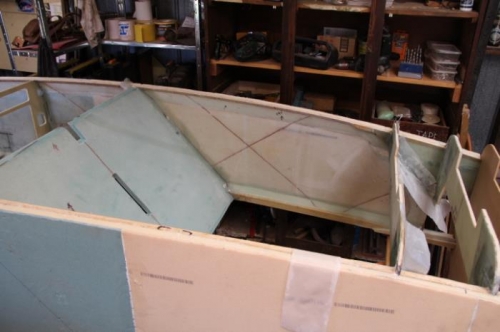

Brief Description:  MLG Bulkhead reinforcement
Applied 6 x UNI reinforcement to back of FWD MLG Bulkhead, and 2 x BID tape to side. Plans here imply the tape goes on after the UNI, so I did it that way this time, unlike previous. It looks lovely and better finished on the side, so will do it this way in future unless the plans say otherwise.
Same method previously described for tapes used for the reinforcement. All the plies of UNI were taped at the edged to stop fraying while wetting out and squeegiing on a plastic cutting sheet, then cut to final shape with a 'pizza' cutter. The sheet cleaned up fine with paper towels and vinegar.
Found I had missed one tape on the seatback, "tape me" plaintively scrawled on the upper longeron, but I can't see it now... Tape applied
Reinforcement
Reinforcement
Peel ply
