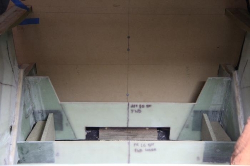

Fit F28.
Glue spacer blocks to locate AFT Landing Gear Bulkhead and install with flox.
Fit spacers/drilling templates to Lower Forward Main Landing Gear Bulkhead with hot glue.
Install F28
Main Landing Gear bulkheads
