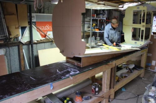

Brief Description:  Trial fit bulkheads
Farted around trying to try the bulkheads, due low overhead in the shed. Seatback impossible. Did some trimming on the others. When temporary firewall and F22 fitted sides seem a fraction long, but hard to tell with everything wobbling everywhere. Need a new plan.
Became alarmed that F28 doubler is too far aft. Then discover the doubler being fitted is confusing me. Even so I think the doubler should protrude, yet it is a fraction short.

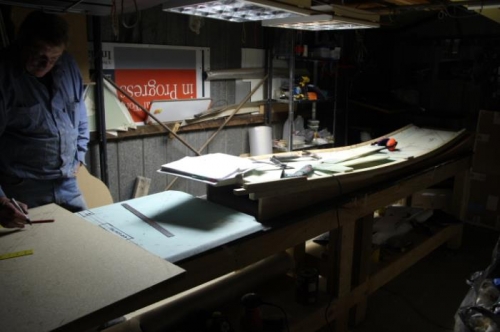

Redesigned seat brace. Will have no fuel valve, and intend electric landing brake so redesigned for a larger pocket. [Timewarp 27/05/14: Didn't really understand that there needs to be a void underneath for the throttle cables, so had to redesign while assembling, pocket is still bigger than plans.]
Remarked seatback holes.
Trying to try fit bulkheads
Rethinking the seat brace
