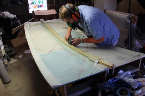

Brief Description:  Trim sides, finish electrical channel.
Trim upper longeron layup. Refit right side to form with bondo at 7/8" spacing.

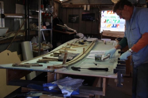

Notched lower longeron as per plans, even though mine have a square section at the rear.
Cut triangular notches in I-clamps. Fitted lower longerons with flox at measured position. Located at W.L. by nails, clamped with the I-clamps, with the wedge underneath. Broke it between notches in a couple of places. Fixed with flox and extra nails.
Trim sides
Trim sides
Notching lower longerons
On with the lower longeron
