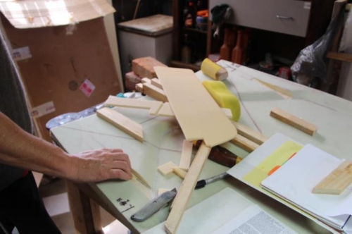

Cut electrical channel as per plans. As per FAQ put a fillet of foam in bend to avoid breaching channel when shaping outer skin. [Timewarp 28/06/14: Was useful, sanded into point of inserted fillet]

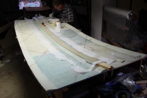

Applied 4 x UNI along upper longeron. Right side came loose, and decided this would make the layup easier without the gap between. Right side needed a shim underneath to line up.

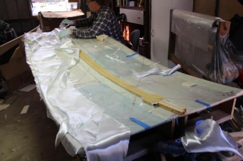

Applied 1 x BID into electrical channel. Plans weren't clear on the idea, but I overlapped 3/4" onto surrounding glass.
Cutting electrical channel
glass upper longerons
Glass electrical channel
