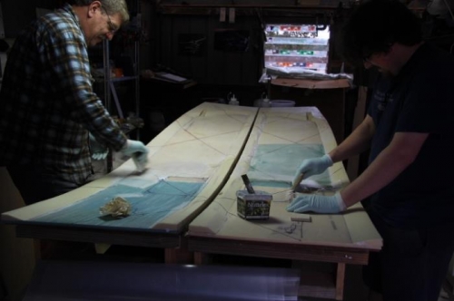

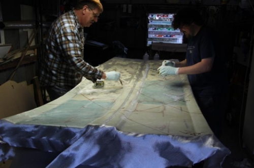

layup inner side
Apply 2 x UNI @ 30 degrees. Trouble getting the peel ply to lay down. Will pre cut in future. Took 5 times the micro I was expecting, didn't keep track of how much.
Micro, micro
Stipple, stipple
Peel ply, peel ply
