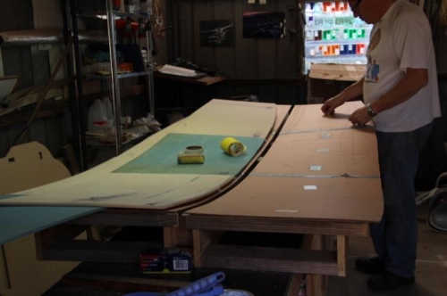

Brief Description:  Make and attach spacers
Fixed sides to formwork. Used double-sided tape instead of the plans bondo [Timewarp 25/04: Should have used more tape, right side kept coming loose, eventually had to fix it with bondo, no problems left side.]
Plans say use a band saw to cut the spacers. Haven't got a bandsaw. Used a panel saw and did a crappy job. Pullsaw and coping saw were worse. [Timewarp 09/05: Found when cutting bottom spacers a method that worked. Position the foam so the lower cutline is at the edge of the table, cut visually along top cutline, with the bench looking after the bottom cutline. Leave an allowance, if the lower cutline is AT the edge, it will end 1/8" short for some reason]
Stuck on the spacers. Discovered a better initial bond if butter both sides of the foam, rather than just one, like I did with the Longeron laminates.
Fixing sides to forms
Cutting the spacers
Cutting the spacers
Fixing the spacers
Fixing the spacers
