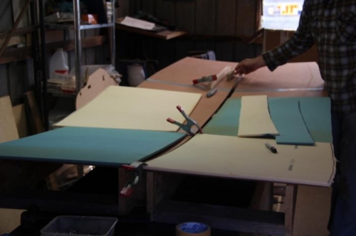

Brief Description:  Finished formwork
Finished masonite for formwork.
Omitted sight guages, will use Vance's, planning to mount on rear surface of strake, so no preparation required yet.
Cut side foam.
Spent some time figuring out side windows. Not aware of anybody who has incorporated these in the initial build. Also planning not to use the plans method of fixing windows, rather bonding them from the outside using Sikoflex, as in the Glastar/Sportsman and others, after final paint!

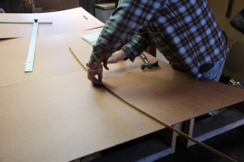

Plotting the bottom curve of the formwork

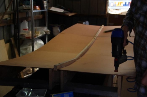

Tacking on the foam. Flat head nails would have been better
Cutting the foam
Cutting the foam
