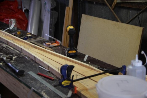

Laminated upper longerons with flox without incident. Plans don't actually say how to do it. I clamped 2 laminations together, then buttered them with flox, then put the clean lamination between. Maybe I should have painted the clean lamination with epoxy on both sides.
Didn't want to stop, so took a chance and put on the doublers/stiffeners before cure. Only problem experienced was the fixing nails spreading the laminations. Where this happened I withdrew the nails and moved the hole a bit to hit the lamination.

buttering up the laminations
Clamped up and nailed, with rear doubler added
