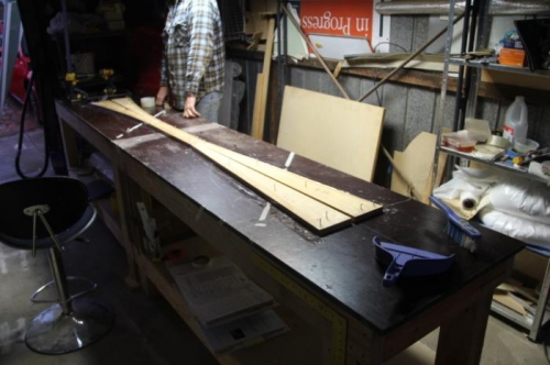

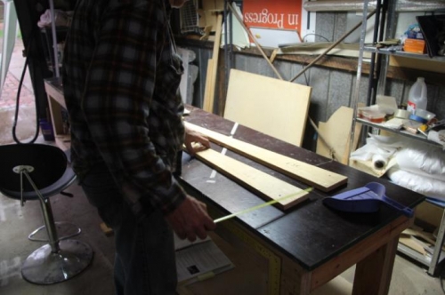

Brief Description:  Upper Longerons - Prepare formwork
These jigs were passed on to me by another builder, and I actually helped him with some of these jobs, on the mighty Cozy Midnight 1200. Thanks Drew. Regardless, I checked them against the plans, and found them to be good. FJC/FJB/FJA x 2 nailed to bench, after marking the bench centerline. Box tape applied to edge and bench.
Trial fitted my laminations. They vary in thickness a bit, so arranged them to add up to 3/4" and experimented with the placement of my limited number of clamps.
Checking jigs
Checking jigs
Jigs nailed to bench
trial fit laminations
