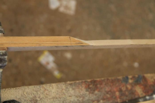

Cut out all wooden fuselage parts for fuselage sides from 2 x 1" planks of Hoop pine. Only departure from plans was cutting the last 20" aft of lower longeron square, with a 1.5" transition, instead of using 2 pieces of triangular.

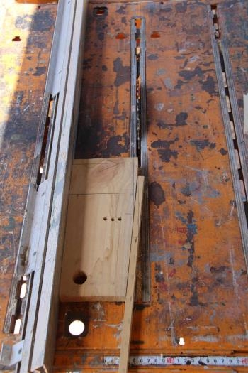

Cutting stiffener on table saw
Bottom longeron with transition
