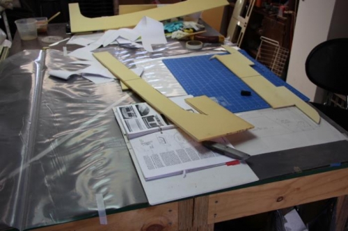

Prepare foam and glass for LG bulkheads. 5 minute hard points into foam. Bit of flox to fill gaps around edges.
The three #1 layup hard points now appear too thick, power sanded till they weren't.
Upper FWD bulkhead was too narrow so grafted a bit in.
Cutting out the foam. Template under the plastic

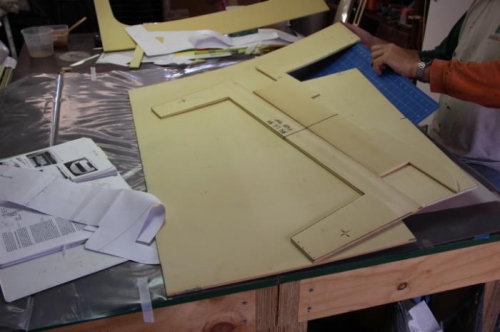

More foam cutting

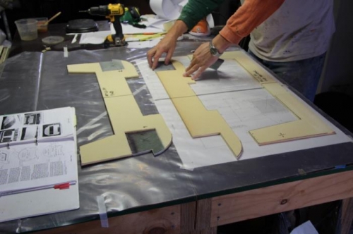

Fitting in the hard points
