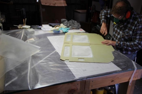

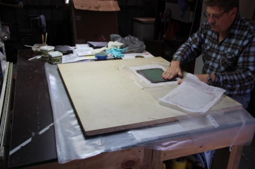

Brief Description:  Instrument panel - trim front. Layup MLG hardpoint
IP trimmed again. Looks good this time.
MLG hardpoint layup TOO SMALL. Plans say 12 x 8" and mine turned out 10 x 7". I can only claim complete idiocy & didn't check my work. Will yield 3 out of the four I need, so will need another layup. When I place the templates over the plans grid I could not find an arrangement that yeilds 4 hard points, so feel better. 12 x 9" would cover it! [Time warp 28MAR14: They were a bit thick too, despite being weighted with 1/4" spacers. 2nd one was spot on. Fixed with power sander]
Hard points layup
Hard points layup
Trimming IP again
Trimming IP again
