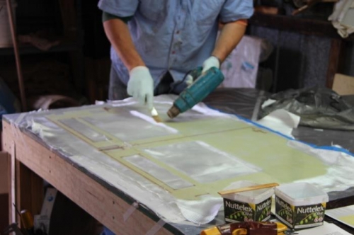

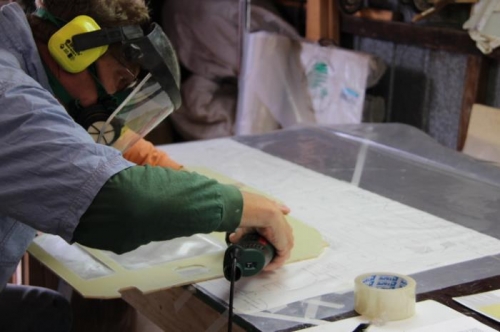

Brief Description:  Instrument Panel - trim rear layup front
Trimmed rear of IP. Layed up front. Used heat and seemed to use a lot less epoxy, wetted out much easier [Time warp 20MAR14: Too much heat. Layup fail! Used 1.3 on the gun, less and further away works better]

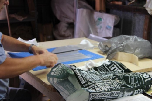

Cut lots of 2 and 3" tapes for IP and bulkhead taping. [Time warp 23MAY14 could have done 3 times as much, just for chapter 06]
Cut 28 x BID for landing gear bulkhead hard points. [Time warp 21MAR14: Ended up 10 x 7" instead of 12 x 8". Can't account for why. Had to do another as the first only yeilded 3 hard points]
Trimming rear IP.
Trimming rear IP.
Applying too much heat to front of IP
Cutting tapes from scraps
