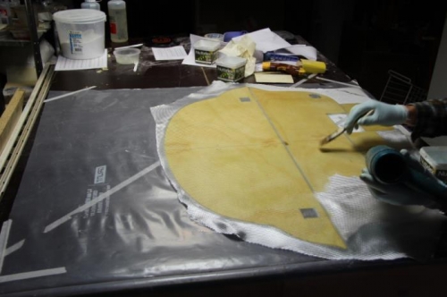

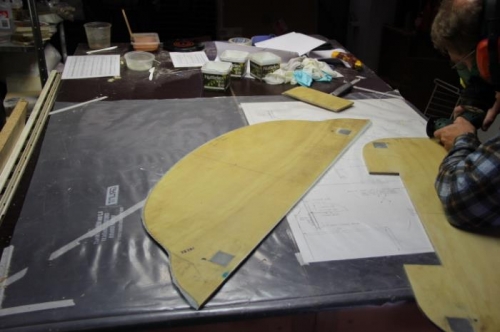

Firewall pieces - Trim aft face, layup front face
Trimmed aft face of firewall with multi tool and sandpaper.
Applied 1 x BID to front face, light heat applied.
Omitted plans mounting screws, will use clickbonds later.
