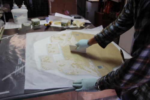

Firewall pieces - redo aft face
Injected epoxy in some delaminations upper FWD Mail Landing Gear Bulkhead.

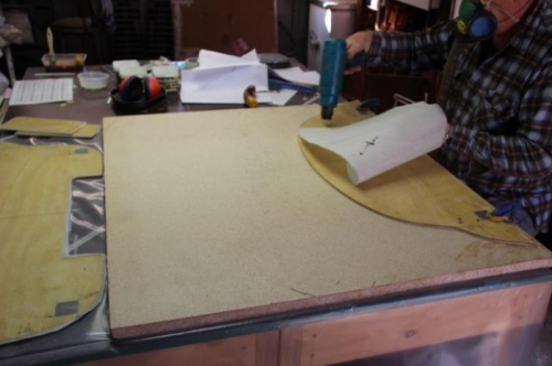

Inspection showed yesterday's work was crap, dry layup over more than 50%. Possible applied too much heat, or maybe too cold overnight???
Stripped off layup with heat gun on high and did it again.

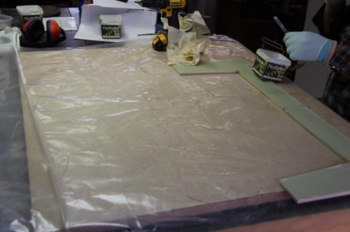

Filling some delaminations upper FWD MLG bulkhead
Stripping off yesterday's work
Redo
