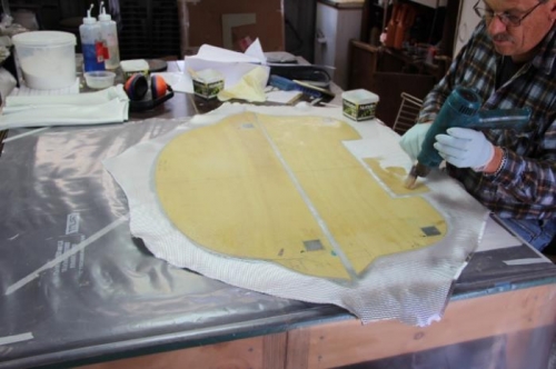

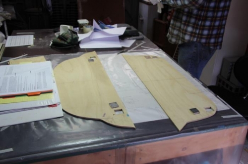

Rechecked templates and placed plans under plastic.
Treated aluminium inserts prepared earlier with soapy water and a scourer, then Rainex, then alodine. Didn't color the aluminium much. Fitted with 5 minute epoxy.
Glassed aft face 1 x BID, peel ply & weighted
Checking plans/templates again.
Fixing the inserts
Fixing the inserts
Bit of heat to wet out
