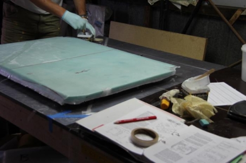

Seatback - layup rear face. Instrument Panel - cut

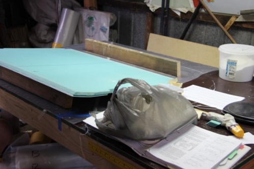

Apply BID for rear face of seatback, completing my first flox corners!

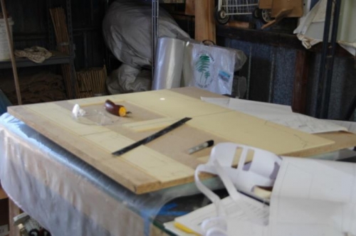

Cut out foam for instrument panel. Noted pencil marked the 18 lb foam nicely and used it. In service the pencil just wiped off, had to re-do with texta.
Trowelling in flox. May have been a bit dry.
BID layup
IP bits
