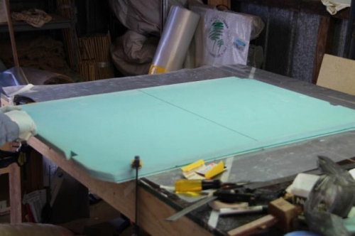

Trim front face. Profile corners for fuselage sides, recheck 76 times to ensure I get all the bits in the right place and the angles right. Cut bottom bevel.

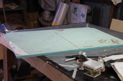

Cut foam for flox corners. Plans don't say how big this should be, but the instructions in CH03 say if this is important the dimension will be given. Based on pics on other's build logs cut a 1/4" joint, which got a bit bigger with sanding.
[Timewarp 06MAY2020 - That's right, 6 years in the friggin future - Still waiting for guidance on flox corners, so I've been using 1/4" since this day. The diagram on page 3 in Chapter 21 is the first depiction encountered of a flox corner, and it is tiny, about 1/16". Wow. From now on I will aim at about 1/8"]

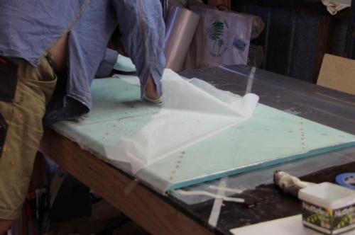

Prepare glass.
Simple joy of composites. The satisfying scrunch of removing peel ply!
Profiling corners
Profiling corners
Cutting foam for flox corners.
