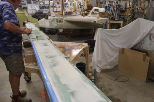

Slow progress for most of a month. Nice and hot here, with the in-shed temp over 40C for day after day. Working for 1 hour continuously maximum most of the time.

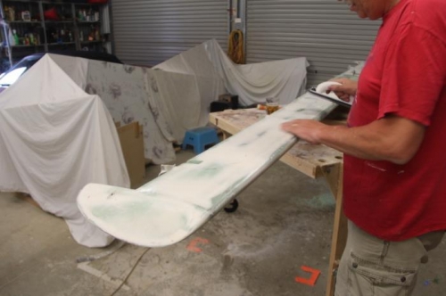

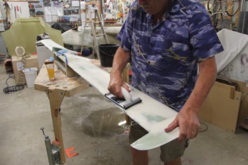

Wet sand with 220/360g. Blade fill a couple of blemishes and repeat.
Put the canard back on its inverted stand, and discover most runs had been captured by the tape, but not all. And I'd thought I'd been careful to not let ANY get away from me... 3 lines of tape next time for the leading edge, trailing edge would be fine with one.
Carefully remove the tape, and remaing blobs removed with 360g wet sanding.
Happy with result finally. Modify my canard storage jigs to allow for the fixed canard cover, and put them back on the shelf for storage.
