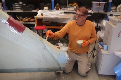

Removed blue wing foam and cleaned up some blobs of this and that. Prepped foam and layed up 3 x BID into an end rib. The first two overlapped onto the spar tip, the last just onto the forward face, which is probably a better idea.

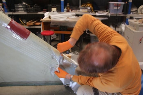

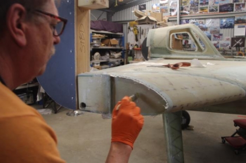

Smoothed and profiled the port hardshelling, prepped the remainder and applied 2 x UND as I did starboard side. Except for the things I did different. I cut the UND inside the window frame, to help it to lay down into the flange, and I only peel plied the edge. I did not mark up the ply directions onto the foam, as I found it of no benefit last time.
Making the end rib
Making the end rib
Trimming the 2nd ply
Wetting out the peel ply tapes
