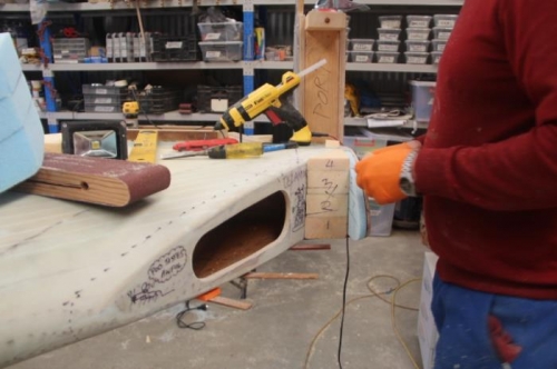

Fiddled some more with starboard outboard fairing blocks, and marked ply directions and overlap boundary. [Timewarp - did not find this of value. Didn't stop me being confused about which ply direction I had already done, and the lining up of the thread direction is easy reference the leading edge].
Note some rough bits underneath and bulk fill with dry micro.
Trimmed port fairing blocks, and installed H45 block assemblies with urethane glue, and wing foam with hot glue. Pinned with nails and clamped with hot glue blocks for cure.

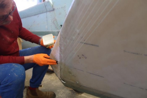

Final profile and marking up

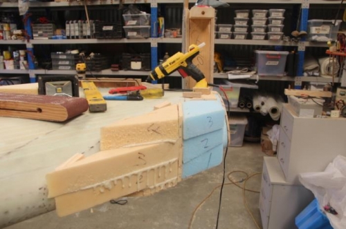

Block #1 & #2
Block #1 & #2
Block #3 & #4, and a packing bit.
