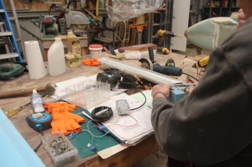

Roused out my landing light, an Aveo Exceleron Daylite I picked up for a reasonable sum at Oshkosh last year, and the BMW electric mirror mount I had intended to fit into the nose and gazed at them for a time.

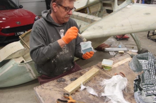

Make a urethane foam form to make a bracket around and layup 10 x BID over it.

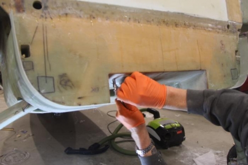

Prep the foam, and apply 2 x BID inside the hell hole, over the site for the gascolator, Taped up the drilling template, opened up the layup throught the drilling template with a nail from inside, and clamp the drilling template on top of the layup with cleco from outside.
Landing light bits
Landing light bits
Making a bracket
Making a bracket
Clamping the layup
Clamping the layup
