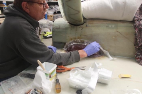

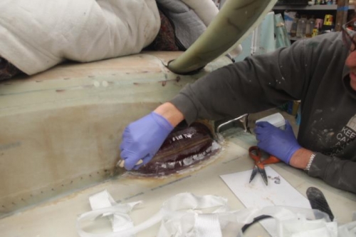

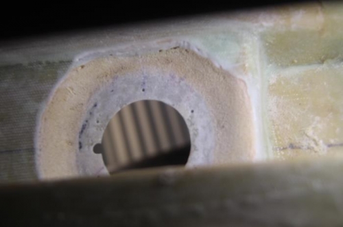

Fuel blisters and gascolator
A bit more profiling on the gascolator site, and am happy for the moment, further works when the plane is on its wheels.
Trimmed the fuel blister flanges, profiled with wet MGS flox and taped wetly with 1 x BID and 1 x 4oz.
Gascolator site
Tapey, tapey
Tapey, tapey
