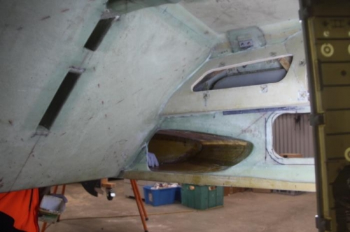

Luggage area taping
Taped the starboard luggage area, same method as yesterday.
Fixed tapes to the upper longeron from the center section spar, 3 x BID.
I x 4oz tape over fuel probe wires.
Wasted a batch of resin by mixing up MGS & EZpoxy. :(
Groping around.
