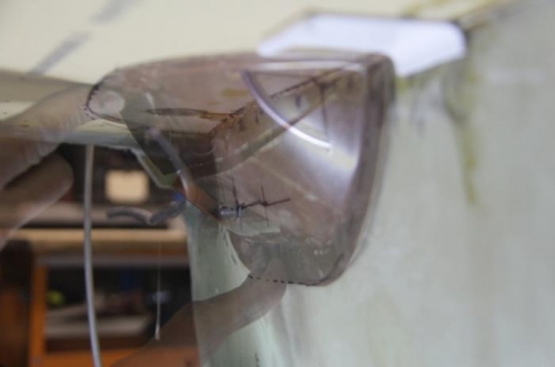

Bent up a pipe feeding from the sump tank to where I expect I'll put a fuel valve, cut it from the first pipe I screwed up.
Took an image of the fuel feed pipe with and without the blister fitted, made one 50% transparent and merged the images. I think this could work.

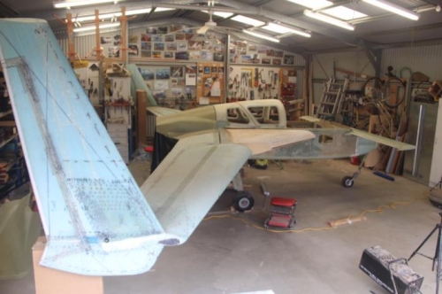

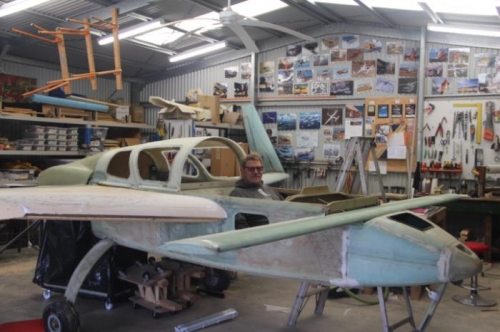

Hot glued the false ribs to the leading edge of the strakes, lined up with the wing roots. Wheeled the motor into position, balanced the top cowling on it. Whacked the canard on the airplane and climbed in to make some aeroplane noises. Put the canard and cowl away, and assembled the wing table, preparing to pull the wings off.

Feed inside the blister.
The Spodplane, all bits together
Brrrrrmmmm, brrrrrrrrrrmmmmm!
