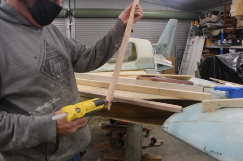

Port strake follows the curve of the ribs much more closely, I suspect because I gouged out the foam in the slots deeper. Tip is kicked up a bit, so hot glued some strips of wood from midspan to the tip, and then on to the wing root, to make all straight.

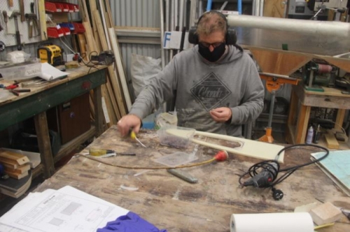

Trimming OD, whilst trying out a home made mask, so I can be part of the mask debate...
Come on aeroplane, straighten up!
