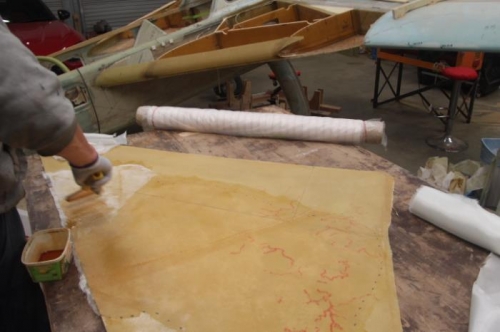

Another 4 hours today removing the last of the dreaded 'sheers'.
Sanded repair area flat, marked the edge and squeegeed raw EZpoxy over all. Placed BID patches over the couple of small areas actually visibly damaged, then nice wet 4 oz over the repair area with REAL peel ply over the repair.

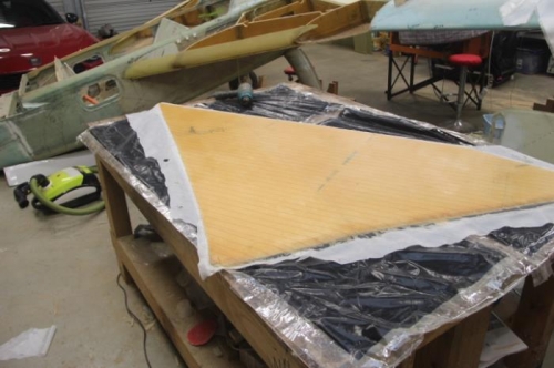

Assembled and finished trimming port strake top core, prepped and layed up 1 x BID with REAL peel ply overall.

Rollering out the repair area
Port side, with proper peel ply
