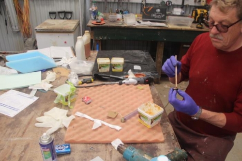

Couldn't do anything yesterday, the plug fell out of the epoxy hot box, and my EZpoxy hardener has crystallised... I had a small squeeze bottle full of previously crystallised hardener, so returned it to the can and heated for 2 hours at 140F in an urn. All lovely and runny again.
Pinned the beanie and filled last sight gauge end.
Installed starboard sight gauge the same as for the sump.
Floxy, floxy
Floxy, floxy
