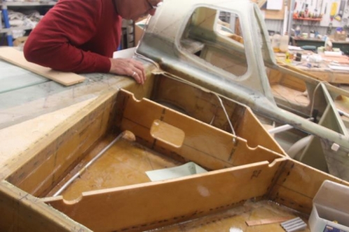

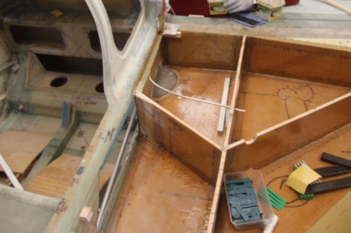

Was concerned that flox from the fitting of the top skin could block the aft corner non-plans vent line, so decided to add to the T-hatting in this area over the vent line flox through the strake top skin, so hot glue a bit of plastic to a hot glue block, then hot glue this to the spar. Pack around the vent lines with flox, then 1 x BID and 1 x 4oz over the flox, overlapping on the fuselage side, the fuselage flange, the plastic and the spar.
Started floxing, clamping and taping the vent lines and smoke oil line, but have to go to work soon...
Floxed the feed tubes into the sump sight gauge.

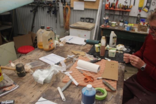

Trimmed the sight gauge beanies, and put one in a jar of unleaded petrol. It floats. I'll leave it a couple of days and see if it dissolves...
Vent protecting flange
other side
other side
Inspecting beanies
Inspecting beanies
