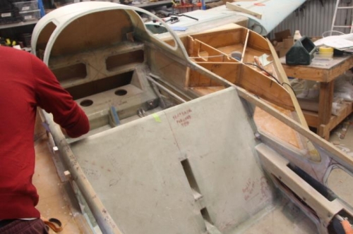

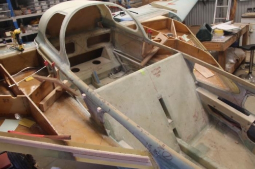

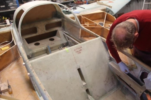

Brief Description:  Taping luggage cutouts and strake leading edge
Using MGS resin, filled flox corners and applied 2 x BID tapes over lower luggage cutouts. 1 x BID tapes inside and out of leading edge skin. 1 x BID tapes over join between leading edge and inner strake skin, inside the luggage area.
Made far too much flox, so used remainder to fit sight gauge fairing pieces and prefill of upper luggage cutout flox corners and a couple of divots.
Taping, taping
