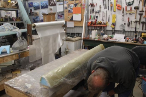

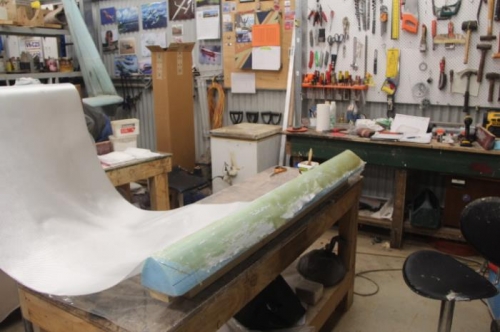

Starboard strake leading edge
2 x BID onto the leading edge form with EZpoxy, and peel ply.
1st ply
2nd ply
Peel ply and plastic, coz I'll need a heater tonight
