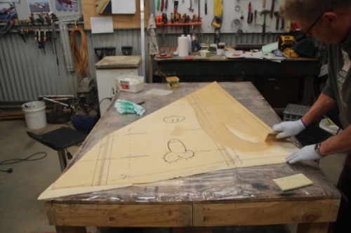

Decide that something uplifting should be visible through the filler when gassing up the Spodplane, so make an attempt at a suitable life drawing on the foam.

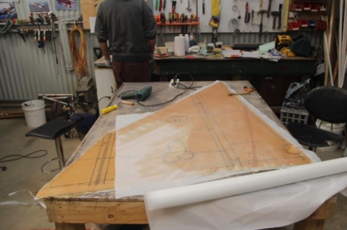

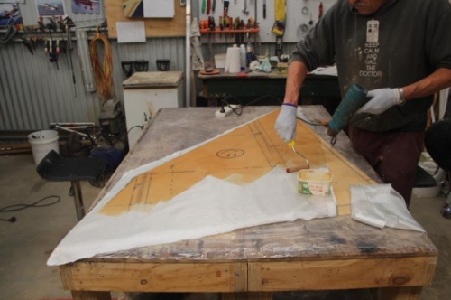

Prep the foam, using a plans rubber squeegee for a change, but it just can't get the excess micro out, so back to a credit card. I am running out of credit cards. Then 1 x BID over inside skin of port strake, 537g of EZpoxy used. Really liking this roller caper, try to clean it with acetone afterwards. Maybe worked. I vaguely remember covering the starboard skin with one width of BID, but I can't find a join, and seem to have misplaced the pictures. The join may be under R57

Slather on some micro.
Rolling, rolling
Rolling, rolling
Getting a bit low on peel ply
