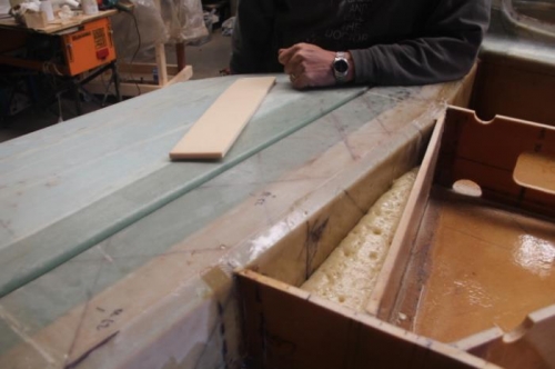

Filling starboard strake void
Fiddle around with other stuff and clean up a bit. Getting together a shopping list, coz Aircraft Spruce has a discount on.

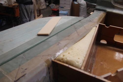

Progressively top up the starboard strake void with pour foam, a total of 140/140ml, in about 4 batches.
Hack some rough holes in the starboard fuselage side and marvel at the view from inside.
Trim the pour foam when cured.
[Timewarp 18APR20: The joint visible forward of the void is where I found the pesky peel ply still in place]
It crawls!
It slithers!!
The Blob!!!
