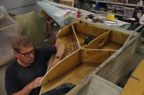

Brief Description:  Starboard strake, taping bulkheads
Trimmed tapes, all OK. [Timewarp 18APR20: just discovered a peel ply that had not been removed, and spent an hour chiselling it out]
Removed table and knocked off blocks. Pulled apart table and reassembled upside down for port side.
Note that the leading edge of the strake skin droops between the bulkheads, probably because I omitted the forward bulkheads, because I'm planning a wet leading edge, a reverse engineered version of the Featherlite creations, which are no longer available. Pondered this concept for a while. If it doesn't pan out I can always put in the dumb bulkheads.
