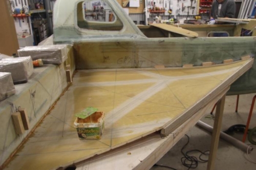

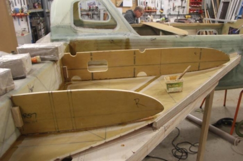

Brief Description:  Starboard strake, assembly
Installed right strake lower skin with flox, then loaded on all the bulkheads, held together with a collection of hot glue blocks, nails, clamps, wedges and weights. It was alarming getting them all to line up. Adjust one and the WL. 17.4 marks go. Fix that and something else slips. Crap! [Timewarp 10APR20: On the port side I just installed the ribs first, that was easier and gave something solid to install the others against. I also taped the ribs/fuselage/spar before installing the other bulkheads over the uncured tapes. Worked brilliantly, and was much easier because of longer runs and better access, particularly in the void]
