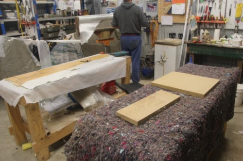

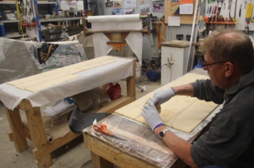

Strake bulkheads
Sanded back hardshelled bulkheads and prepped remainder of foam.

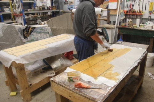

1 x BID over all, using 825g of AeroPoxy spread with a mini roller that fell apart by the end. Intend a more professional looking roller for the next big flat bit. Peel ply over all.
Micro, micro
Rolly, rolly
