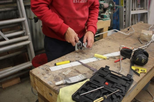

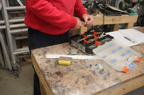

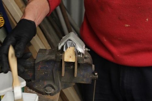

Fuel valve
Trimmed bracket and trial fitted.
Riveted two K1000-3 nutplates to some scrap glass, match drilled the bracket, and floxed it into an excavation on top of the heat duct.
Bonus pic of bracket
Fettling the bracket
Bonus pic of last fuel line
