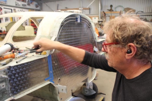

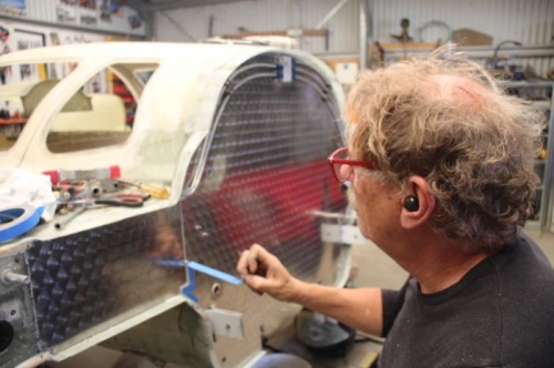

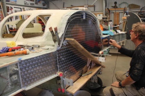

Brief Description:  Metal firewall - making pretty
Removed rudder cable brackets, and taped up edges of metal firewall pieces. Ran a bead of the Fire Flex around each join or edge, ripped off the tape and refitted the lower rudder cable brackets.
Squirted some more Fire Flex in a big gapey bubble around the NACA, and refitted a more minimalist clamp to secure it.
