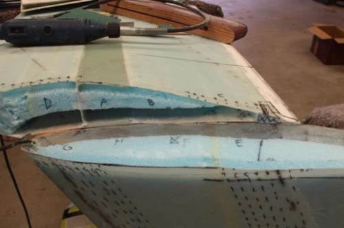

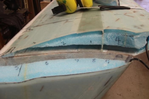

Manual Reference:  20-04
Brief Description:  Prep for Layup #1
My TC was keen on inspecting structural layups before covering them up, but that would require about 4 inspections to see each stage of the Winglet install before hiding them, so we agreed to document each clearly.
These are the pockets prepared for Layup #1, which attaches the inside surface of the upper wing skin to the inside surface of the inside Winglet skin.
Right Wing
Right Wing
Left Wing
Left Wing
