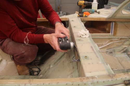

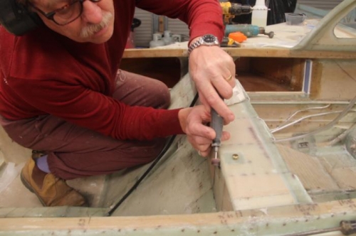

Manual Reference:  08-05
Brief Description:  Shoulder rest harness attachments
Removed clamping bolt to see if the nutplates would fall off. They didn't. Refitted clamping bolts, finger tight into the nutplates, just in case. Cut off exposed tabs with multitool and prepped.
Filled remaining gaps with dry micro and taped with 1 x BID and peel ply.
Removing tabs
Removing tabs
Making it purty
