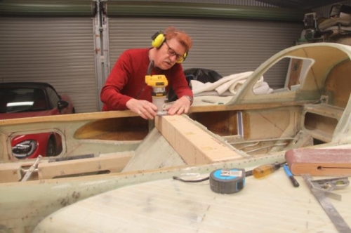

Rounded forward edge with router and 1/4" rounding bit and used a dovetail bit to bevel the foam around the hardpoints. Cut flox corners in the edges with dremel.

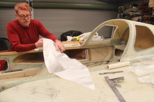

Cut all glass.
Rounding the corner
Rounding the corner

I have one big scrap, and it fits!
