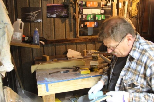

Trimmed inner layup and assembled rear heat duct.

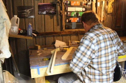

Carved transition piece and covered in box tape. Sanded it square on a sanding board, then pressed on some 40mm PVC water pipe, and sanded in a transition, then eased the round down to 1 7/16". For easy handling spiked it onto two nails driven through a block of wood.

Assembling Heat Duct
Carving transition piece
