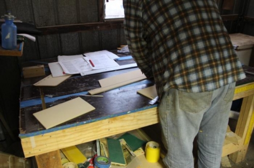

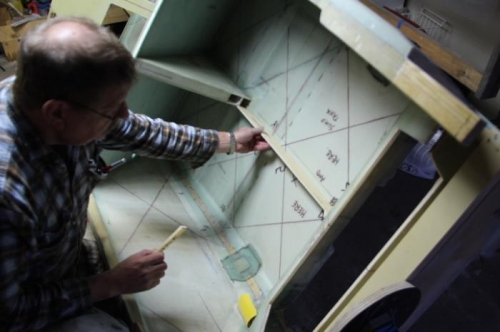

Cut out the foam for the rear heat duct. Rather than the plans paper pattern I cut my foam square on the bottom, and marked the profile with an offset pencil. The plans don't actually say, or give measurements, but I am proceding on the assumption the rear 45 degree bit is supposed to follow the line of the upper MLG Bulkhead. I actually used a bit of leftover glassed foam from the front heat duct for the baffle.

Cutting foam! Haven't done this for a while
Scoring bottom profile
