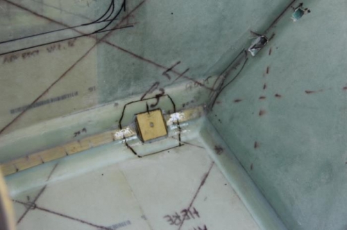

Brief Description:  Outer seat belt mounts
Noted last time the ply pieces moved around when glassing over them, and there was a LOT of flox underneath adding nothing but weight. Took a leaf out of the De Havilland Mosquito, and fitted the ply with a small countersunk brass screw in the middle. This squeezed a lot of flox out, made it easier to make a flox fillet around the edge, and to get the bottom parallel to the inner surface of the longeron.

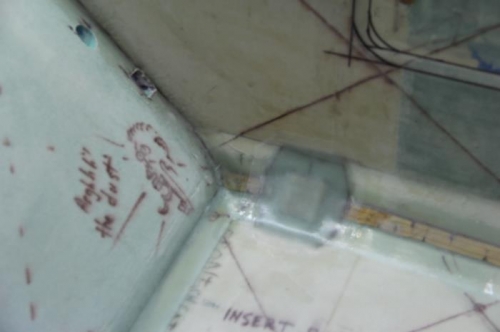

Put some tapes over ground out epoxy runs in front of instrument panel from CH06.
Looks a lot better than last time, I'm almost glad I had to strip the first effort off.

Hardpoint floxed in
Hardpoint floxed in

In and peel plied
In and peel plied
