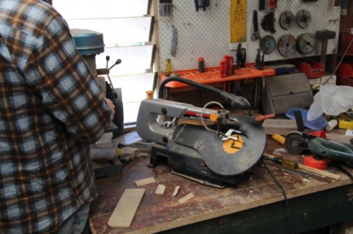

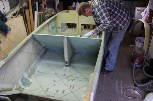

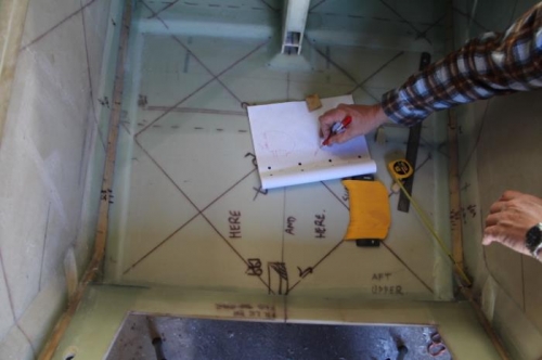

Spent some time figuring out what the ply reinforcements should look like. Profile gauge was too long, so just brutalised a bit of foam to get an idea. Reproduced in 1/4" hoop pine ply using electric coping saw and 2" drum sander mounted in the drill press.
Floxed in position, then 7 x BID over the top, laid up on the bench on peel ply, cut with pizza cutter and pressed over the ply.

Figgering what the ply pieces should look like
Cutting the ply
Cutting the ply
