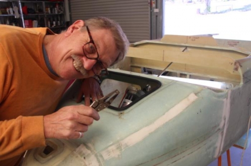

Final installed and torque checked all the rudder pedal hardware, (except 1 bolt I don't have). Had a bugger of a time with washers, so invented a pair of washer forceps from an old pair of dodgy vice grip pliers.

Washer forceps. Invented by Spodd
